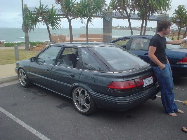

    this is my first post and i can now say i am a proud owner of a corolla!!
    my Ae92 Looks the part, sounds the part, but unfortunantly doesnt go as well as it looks or sounds!!
    i was wondering is the 4a series engine basicaly the same in the bottom end and just have different heads strapped to it? or is it completely different rite through 4ac 4afc 4afe 4age 4agze etc
    because i heard something strange the other day of a 7afge ie 7a head 4agze bottom.
    so is it possible to buy a worked 4age head and strap it to my 4afc block? or is that just wishful stupid thinking.... be nice i am a noob at all this!
    its not that i dont appreciate that my car goes and i mean its great with just me in the car but if you add a 2nd or third person you really really notice a lack of power!

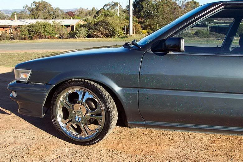

    it handles great lowered 3" in the front and 4" in the rear on 17" avantek *shrugs*
    i payed $3500 coz the guy has a family now!
    any help would be greatly appreciated
    thanks
    Terry
