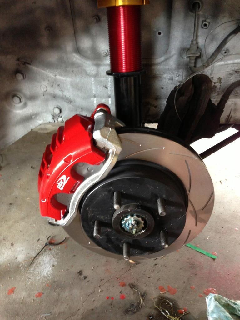

    My Coilovers with Hopper Stopper brakes 5X120 hubs http://www.toymods.org.au/forums/for...back-18rg.html
