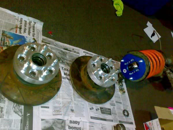

    and sillycars y do u need those wheel spacers? (they're just about the thickest i've ever seen)
    17x8's on the front and 17x9's on the rear, both about +35 offset. they are 25mm spacers

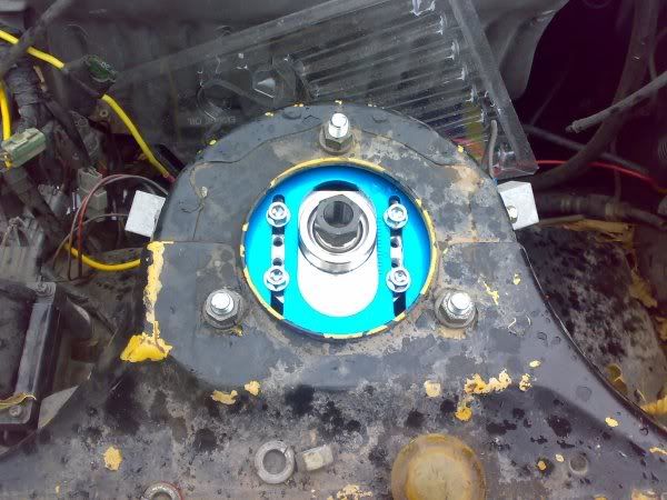

    http://www.technotoytuning.com/productdetail.php?p=313
    I just relised that the $229 price that you got Jase includes the swivel upper hat, and that is why they're not $199...
    I'm in!
    ([][][]II--LT--II[][][])

    what the hell is this guy (technotuning) refering to when he says swivel upper hat and not the strut top? no pic available
    is it just the bit that the top of the spring sits on? then the shock goes through to the camber plate right?
  15. #630
    3,108
    Default Re: [Guide] Corona/Peugot/Hilux Conversion with Height Adjustable Coilovers [56k DIAF]
    With the standard Weld On Coilover Kits, the upper hat (sits underneath the adjustable strut top) is just a solid piece of alloy and does not have an inbuilt bearing and grabs on the adjustable strut tops when you turn the wheels and forces the spring, and lower spring perch, to remain in the same postion as the adjustable strut top (bad)...
    The Swivel Upper Hat is a 3 or 4 piece upper hat system which has a bearing that allows the spring, and lower spring perch, to move independently from the adjustable strut top so that when you turn the wheel, everything below the adjustable strut top moves as one (good)...
