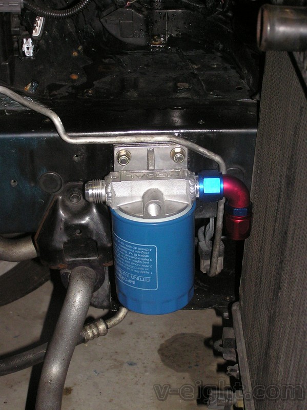

    alt to sadwich plate: full flow inline relocation

    Well, i have -12 lines and fittings for filter relocation. If I can use a plate as described above the I'll have spares . Is there any trick to doing a full flow cooler setup?
    Penrith BC
    2,537
    Default Re: 5MGE and 7MGE Oil Pumps
    nope
    engine->filter->cooler->engine
    -12 the whole way along
    ../delete/ban
    tech moderator
    you can get remote filter/cooler kits that have a thermostat that bypasses the cooler until chosen temp is met.
    also, put a temp guage in (post cooler) so you know what the cooler is doing
