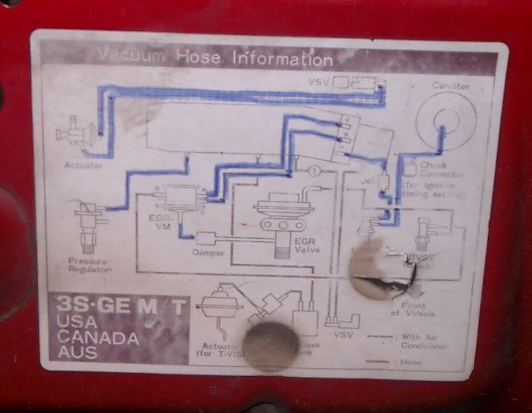

    Temperature-wise I don't foresee any problems, but design-wise there could be a bit of a stumbling block. I have the same BVSV's on my Celica and they are located in the same place and do the same job. My concern is the construction of the valves because the blue one looks to take it's vacuum from two different sources, where as the black one doesn't.
    Are the threads the same? Same diameter and pitch as well? From here the blue one looks to be a tad bigger.

    Default Re: Help with these two BVSV's
    That's what mine looks like under the bonnet, and one side of the blue BVSV (the top part) goes through a 'jet' which leads up to the "P" section of the throttle body vacuum ports, and the other part of the BVSV goes to the charcoal canister. The black BVSV has the top part receiving a signal from the EGR modulator and the bottom part direct from the EGR valve itself.
    So, what does this do for you? If the BVSV's open and close (are functional) as you say, then based on assumptions above I guess it's worth a try. At worst I think the engine will idle rough or hesitate on you while driving if the BVSV isn't doing it's job.
