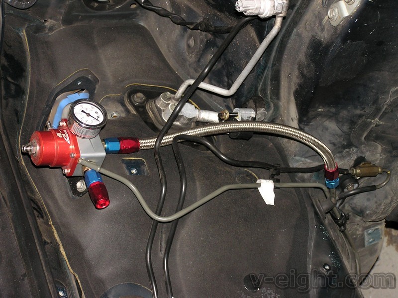

    i'd suggest mounting the FPR on the firewall or guard-arch.
    Things like malpassi's are alleged to fall apart from excessive vibration, and some guy on performance forums had an alloy part on a rail-mounted FPR crack while driving resulting in major engine fire to a genuine sierra-cosworth-turbo.
    ALso, there's no fuel-flow requirement to have the FPR attached to the fuel rail and most have two inlet ports - one taking fuel from the rail, the other to suit a guage.
    FPR goes after the injectors (e.g. tank->pump->filter->rail->fpr->tank).
    Pic of how mine is mounted on firewall:
