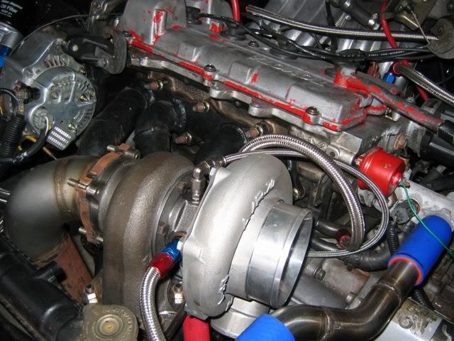

    the gt30r on a 3sgte spools up from around 3000rpm and comes on real hard at around 3600 - 3800. with the .63 rear.
    a little bit laggy, but theres no stopping you once your on boost. being the gt4 it shoudlnt be a problem , launch off, and the lag issue is solved.
    i used a custom manifold, so i dont know about position but id imagine it would be mighty close to the bonnet/radiator with an adaptor in there as well as the .7 front cover.
    heres an idea of one sittin in my engine bay. room and size wise.
    the flange is probably 20mm off the radiator core. would be different with the stock manifold obviously
