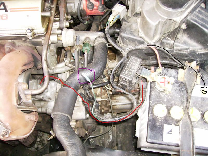

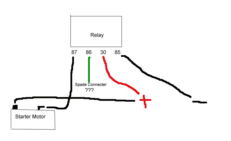

I'd say it's extremely likely the spade connector should go to 86.
The relay has been put there to boost power to the starter, the spade connector should be coming from the ignition barrel.
If you're unsure put a multimeter on it and turn the key, it will most likely get 12v when you do this.
