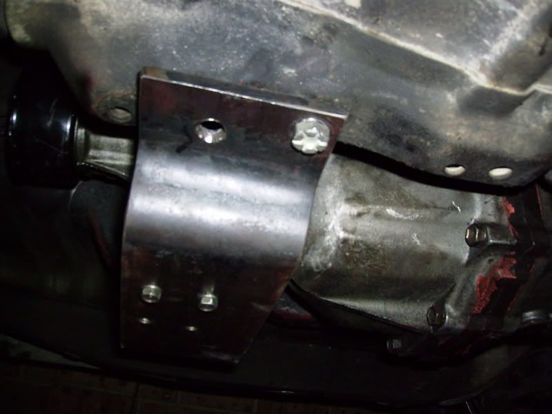

    Just wanted to share a picture I found from here: http://www.ae86drivingclub.com.au/bo...howtopic=10103
    Im going to try and duplicate this exact bar because it seems the easiest to duplicate.
