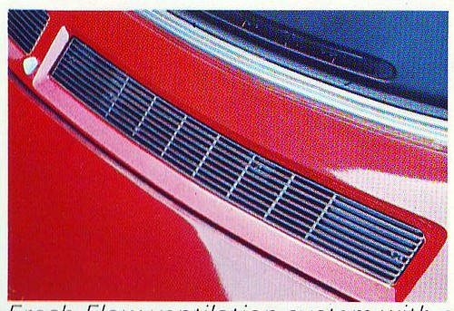

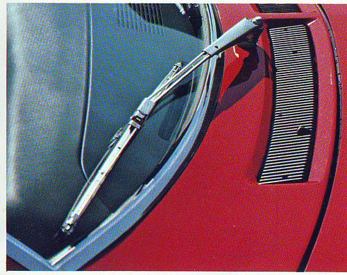

    Early Front vent
    Late Front vent

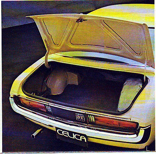

    Early Rear 7012 - 7207
    You can see in this scan the spare wheel in the boot and the flat tail lights are all red (JDM Spec) Here we got red/amber tail lights.

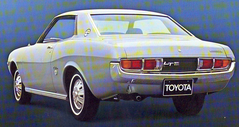

    Mid series Rear 7208-7312
    You can see allot of the variances in this shot. The early style petrol cap is nice and clear as are the rear quarter vents and italic style badging. The early series round edge guard lips are also nice and clear. These all changed in January 1974.
