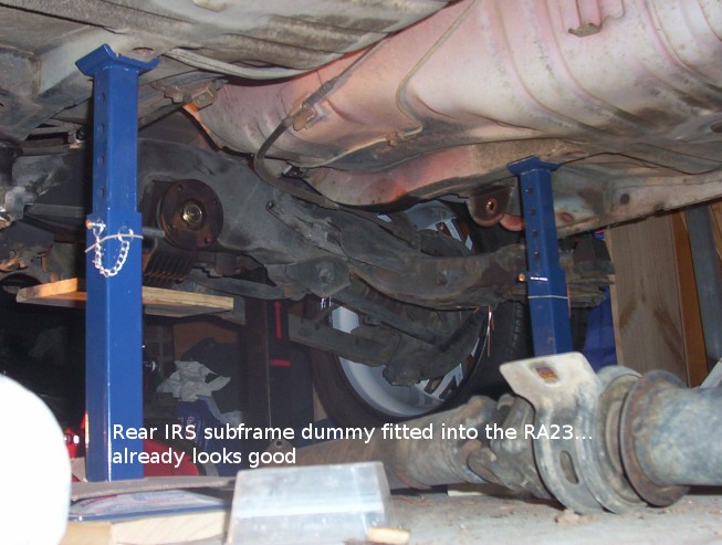

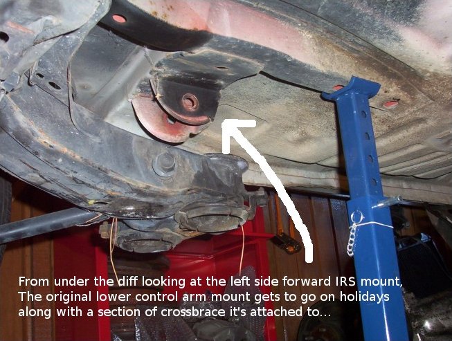

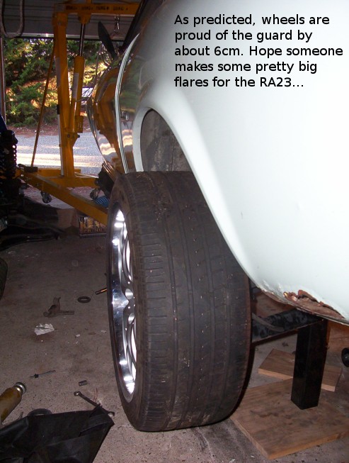

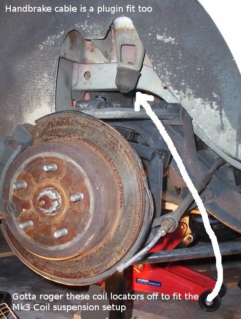

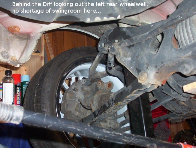

    Well, here I am with another progress report, still working on fitting up the Mk3 Front and Rear, this is a leadon from an earlier post "RA23 vs 2JZ-GTE" found at http://www.toymods.net/forums/showthread.php?t=5785 . I've got the IRS subframe dummy fitted and initial pics to highlight the issues I've so far come across. Interesting though is much of where old and new meet is surprisingly compatible, especially the simple things like intended mount points (rear goes straight through the Chassis Rails, the front looks to be even moreso accurate to the rails) and the RA23 handbrake cable looks to be nearly identical to the Mk3 puller. I've already chucked the old engine and diff, W50 gearbox and RA23 front end is about to help compact the garbage in my wheelie bin. On getting these two subframes fitted, I get to call my engineer to come sign off on it.
    I have a bunch of questions to put forward but right now, I don't have the time to be that organised... I guess I'll post a more coherent list when I get my thoughts together...
    http://www.spartacle.com.au/homegrou...upRear01-b.jpg
    http://www.spartacle.com.au/homegrou...tupRear2-b.jpg
    http://www.spartacle.com.au/homegrou...tupRear3-b.jpg
    http://www.spartacle.com.au/homegrou...tupRear4-b.jpg
    http://www.spartacle.com.au/homegrou...tupRear5-b.jpg
    So when I finally bolt in the 2JZ-GTE and V161, do I get to call this contraption a JZA23...?

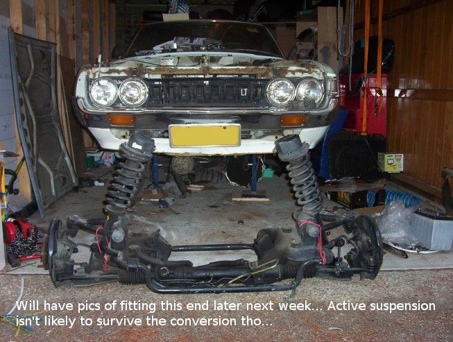

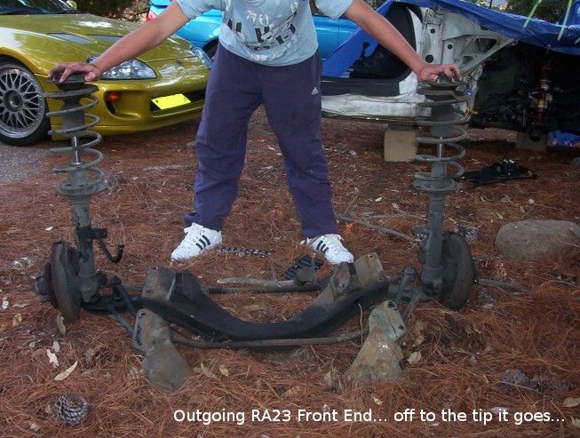

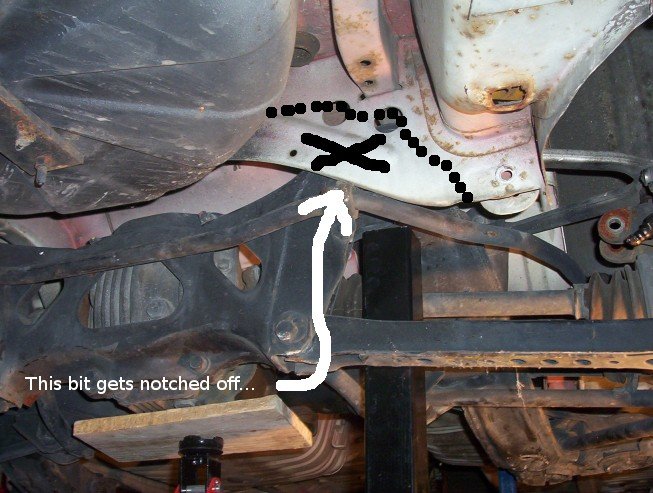

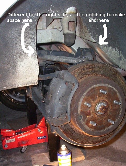

    More Pics!
    http://www.spartacle.com.au/homegrou...tupRear6-b.jpg
    http://www.spartacle.com.au/homegrou...tupRear7-b.jpg
    http://www.spartacle.com.au/homegrou...upFront1-b.jpg
    http://www.spartacle.com.au/homegrou...upFront2-b.jpg
    John Wilson is my engineer in the ACT, This is my wife's car but where someone says we have all the advantages, luck, etc. because we live here, I'd beg to differ. My project car up in Townsville is a very similar beast tho it's a Cortina wearing the same Mk3 Supra suspension but like this Celica has also received preliminary go ahead by that state's certified automotive engineer to do it.
