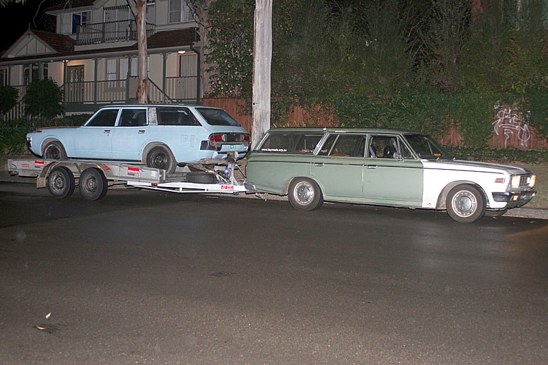

    Mate I do have a crown like in my avatar but its not that one unfortunatly. My MS63 is very very tired. Its the one on the trailer.
    The crown I am putting the 2JZ-GE into is my MS53 Tow car, This one:
    the avatar pic is actually from a sales brochure for the MS63
