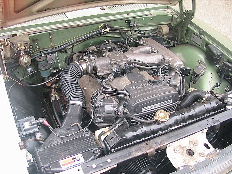

    Once fitted the engine sat in the bay well:

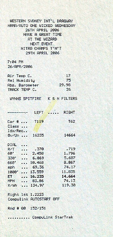

    And it made the 16 second Quarter I was aiming for
    But more importantly it still goes just as well as the day we fitted the engine.
