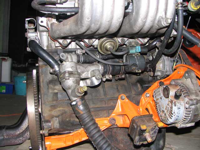

    digging up an old one, this came in handy today - thanks Sam.
    i did my water setup as follows :
    1,798
    Default Re: New 4AGE 20V RWD cooling system conversion guide online
    well that looks fairly neat and simple. The good old universal hose eh
    Hoppers Crossing
    1,130
    yep universal for bottom.
    the 1325 is a holden early heater hose - so like 6 bucks - curves round nice
    the other bits are just pieces of left over top ae92 top hose

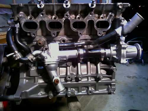

    for the heater out the back of the head I used an AE82 piece, cut off the flange which I think is like a 3/4 inch thick. then trimmed off the length where the 5thinjector thermo and water temp lie and welded that 90 degree cap on the end to the flange. same height as the AE86 one. Then I just moved the Water temp sensor to the bung on the remote thermostat housing. here is a picture of my motor with the FX16 bung unmodified for reference

    could have been an AE92 heater neck, cant remember

    you could of also used the one off the earlier engines, they sit more flush
