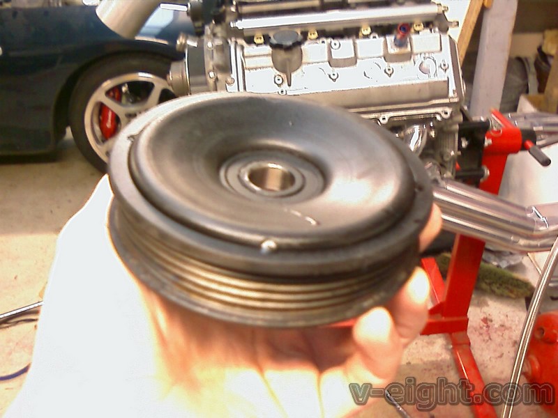

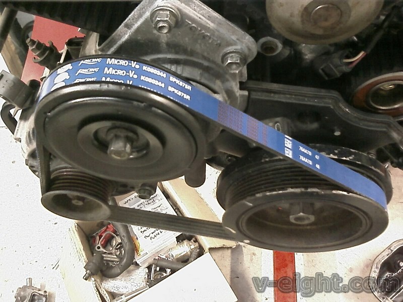

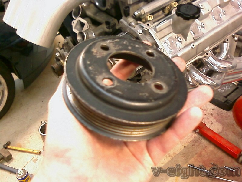

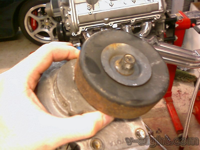

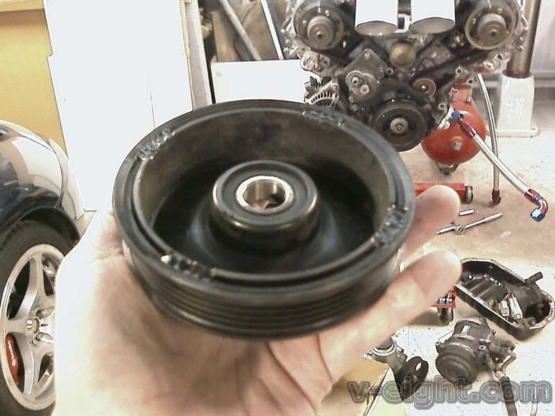

    here's a reprint of what i wrote about doing mine....
    dodgy phone pics included
    pics of the custom 'reverse tensioner' pulley system i rigged up to eliminate the ps pump, ideler, fan pulley, and ac compressor (eliminating around 2m of serpentine belt!)
    complete luck finding an radom 5pk pulley in the dirt at the wreckers, that fit as a perfect tolerance fit direcly over the top of the existing 1uz idler/tensioner. i think its a 7mge water pump pulley.
    anyway, i machined the face off the new 5pk pulley, basically making it a 5pk sleeve, slid it over the existing tensioner, got the belt alignment as close as i could approximate, then welded it all together. note that the existing 1uz pulleys are 6pk, and thus the new 875mm 5pk belt and custom 5pk tensioner pulley alignment were designed to align/run at the front of the 6pk groove set.
    ../delete/ban

    I hung my Alternator off the top mounting factory bracket as MWP has done & made a swing adjusting bracket for the bottom mount so again the same as MWP, no dramas some 4 years later ..
    ED's way looks neat, but i'm just not sure if there is sufficient wrap around the alternator pulley to stop slippage under high alternator loads, if you look at the factory setup the belt wraps a lot more around the alternator pulley ..
