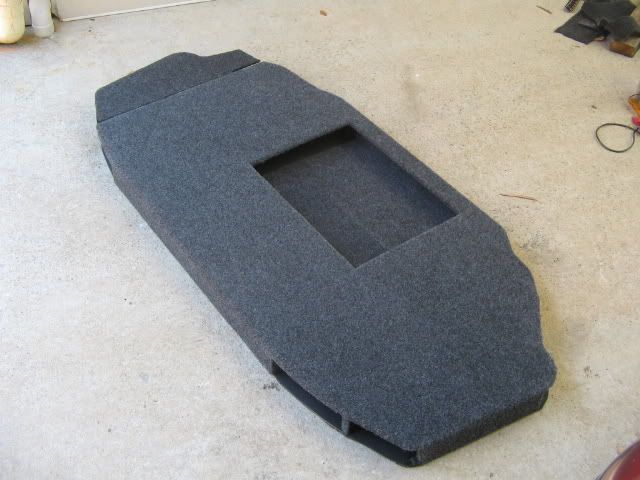

    Default Part 2 continued ...
    Place one sheet on the floor and add the reinforcing timber in the designated areas using wood glue and panel pins. Where you place the reinforcing is up to you, just remember that the height of the timber 'cleating' should be sufficient to allow your amp to sit just below the finished floor.
    Attach one end permanently. I made the left side a separate piece. Here's what it looks like in near finished shape:
    To blend all the pieces together I sprayed the underside, the inside, the timber cleats and all the edges with Matt Black. Allow to dry.
    Cover both the small piece and the main floor with speaker carpet, allowing an overlap on the edges of about 5cm, using the saw-toothed spreader and contact adhesive. For more precise coverage, use the disposable brush.
    Make sure you press all the carpet down firmly and along the edges. It dries quickly on a hot day so this shouldn't be too troublesome. On cooler days allow the contact adhesive to go tacky before applying the carpet.
    Here's the finished floor, note the left hand side is a separate piece:
    The carpet is an almost exact match for the original Aristo boot liner. The photo makes the two pieces look different but it must be the light. They are all the same carpet colour.
